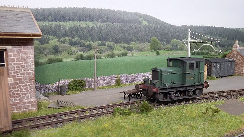

I was able to remove the Bachmann crankpins OK and when assembled, the whole thing then ran sweetly again:
You may notice that I hadn't finished painting the dark rust colour on the check and wing rails, this is now done.
