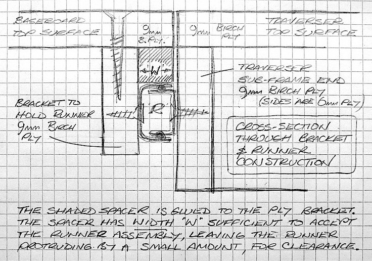

Sector Plate 028 - fitting runners - sketch - reduced for forum - 180508 crop.jpeg
In order to fit the runners to a plywood surface without a machined groove, both parts of the runner unit must be securely fixed at or near both ends and this required the drilling of one new hole in the part that would normally be held in the drawer groove.

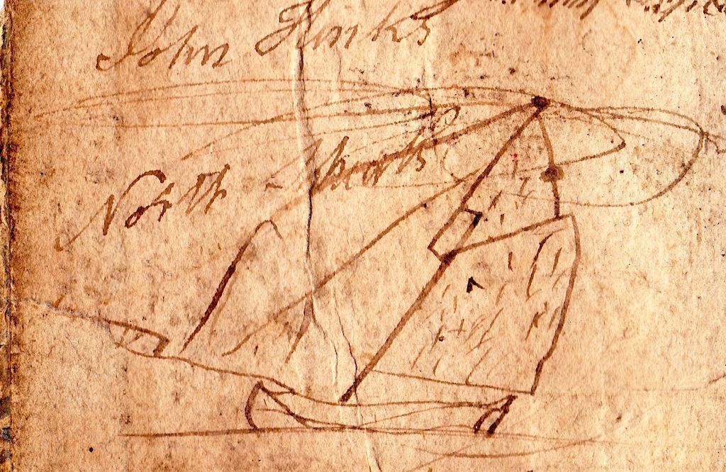

That's a very nice craft. Are you restoring it? I know this is off topic, and boats are not my field, but I came across an interesting inscription in a battered book dating from probably the first or second decade of the 19thC, given to me by a friend. The book is inscribed in several places by a John Winks of North Shields, who may have been the man who later ran a tavern at the Low Lights, or may have been his son. The theme of the book, and one particular inscription, suggest the owner went - or was about to go - to sea. Included amongst the several inscriptions is a simple - even naive - sketch of a sailing boat, which to my eye seems to capture the feel of a boat heeling in a fresh wind:
I think this was drawn by a boy or young man who had observed ships and boats, as it depicts quite accurately the mast and topmast arrangement, the rudder and tiller, and the rather sinuous lines of the hull. The vertical dashes on the main sail are curious but appear deliberate - I wonder if these might be an attempt to represent reefing points. If I've interpreted the drawing, and understood the definition, correctly this boat seems to have the key features of a gaff-rigged cutter. If so, then it's probably not a Tyne Pilots boat, because records suggest that they used cobles rather than cutters. I think, given the owner's family and location, it was probably sketched from direct observation, and possibly near the mouth of the river, at the Low Lights. As I said, off-topic, but certainly relevant to Low Lights history.
