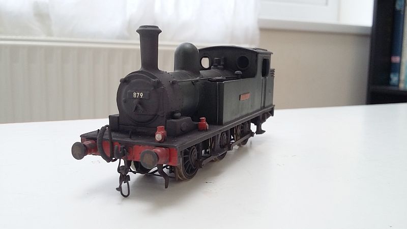

    No work has yet been done to start building the baseboards, but all the pointwork is complete and two locos for the Vale of Radnor Light Railway are also now done. One is the Roxey 'Planet' diesel referred to earlier and the second is a refurbishment of an older model that was originally done over 30 years ago.
    That loco was an old Mainline J72, which I had re-sprayed into a green livery in the 1980s and given the name 'Jennifer', to represent a sold-out-of-service BR loco, that had been acquired by an unspecified light railway. At the time, I had no plans to build a light railway for it to run on, so it remained in its' box for years and the old Mainline split chassis gradually deteriorated to the point where it no longer worked.
    In the intervening years I had also done up another J72, this time to represent one sold out of service to the NCB. This had acquired a compensated Perseverence chassis when its old Mainline one also failed. I used it on 'Engine Wood' a lot in the early years, until I acquired some more suitable examples of industrial locos.
    The objective of refurbishing 'Jennifer' was to retain as much of the 1980s loco as reasonably practical, but also to replace the chassis with a Perseverence one and to weather it.
    This is the finished loco, now waiting for it's outrageously improbable light railway to get built:

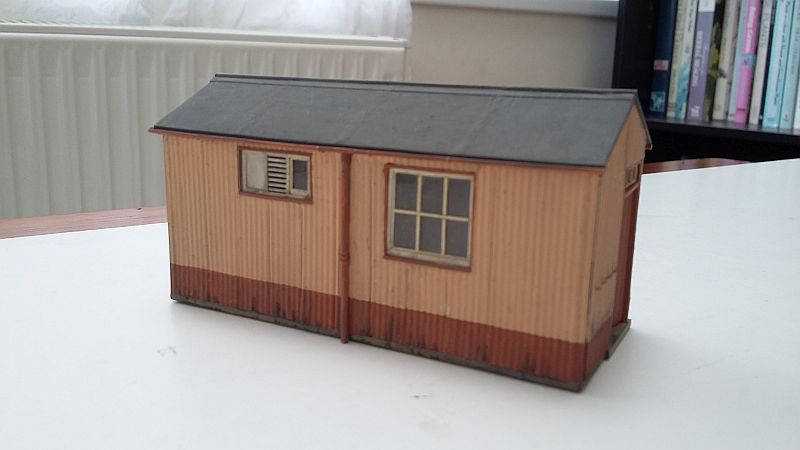

    I've also featured some of the buildings for 'Bethesda Sidings' in previous postings. The goods shed and weighbridge office were scratchbuilt by Paul Iliff, who sold a lot of 4mm items a few years ago, when he (temporarily, I believe) changed to 7mm. They are exquisite models and I feel fortunate to now have them for my layout.

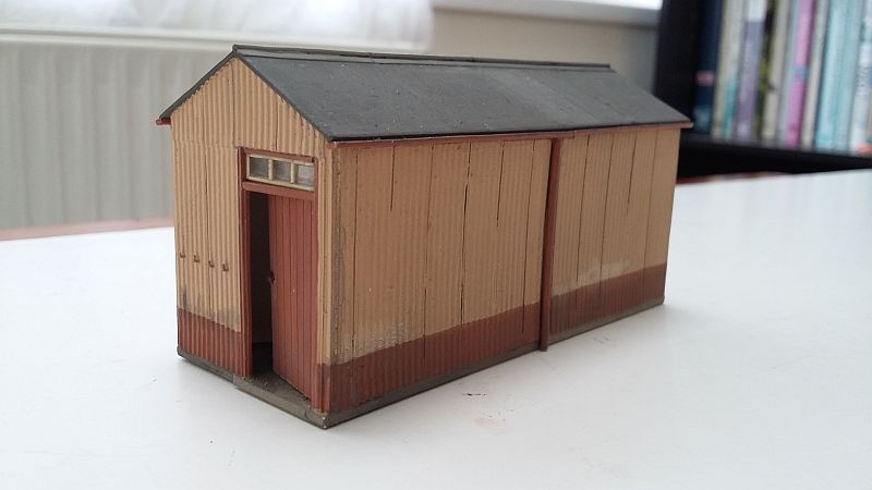

    Last night I was lucky enough to acquire a couple of additional structures for the goods yard, which had come into the possession of our area group, but which were now deemed surplus to requirements:
    Work is currently on-going moving the contents of my 'railway room' to another, slightly larger room in the house, where I will be able to keep 'Bethesda Sidings' put up to be worked on.

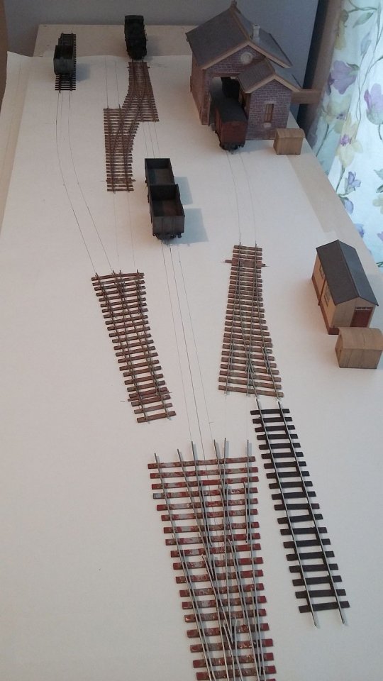

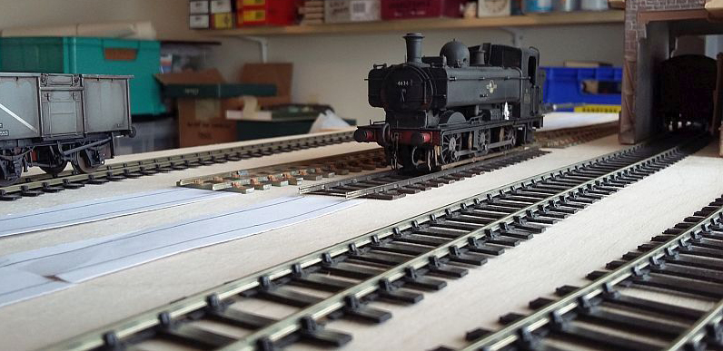

    I had a bit of a 'mock-up' session with the buildings and pointwork for 'Bethesda Sidings' this afternoon. I am now almost in a postion to be able to start building the baseboards and I needed to check how long the scenic section needed to be.
    PMP, Alan, PaulR and 12 others like this.

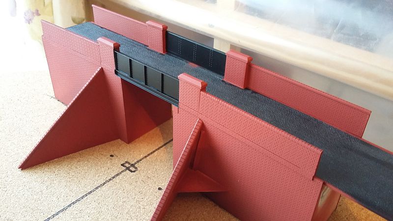

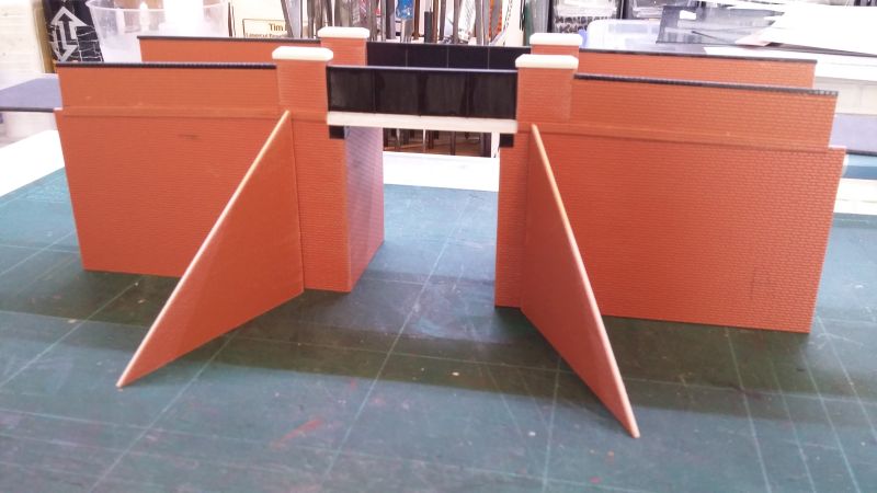

    I've decided not to use the Paul Iliff stone overbridge as the scenic break to hide the exit to the fiddle yard, as it's at quite a skew angle and really takes up rather more space than I'd like, so I've started building a small girder bridge with brick abutments instead.
    The plan for the stone overbridge now is to use it on another, smaller cameo layout based on the light railway itself.
    This is the state of play on the new bridge this afternoon:

    More gluing of baseboard components has been taking place, I'm hoping to fix the top on in the next day or so.
    The overbridge has also progressed and the road deck has been glued in place. Further detailing work to follow, plus the wing walls etc.

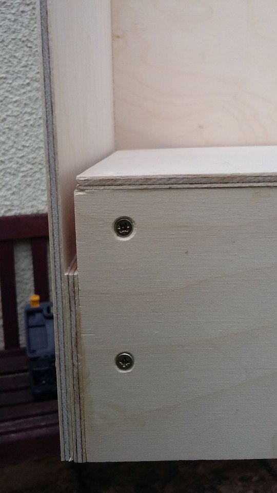

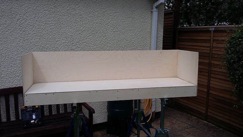

    Work has been progressing on the main baseboard:
    I still have to attach some diagonal cross bracing underneath, however:

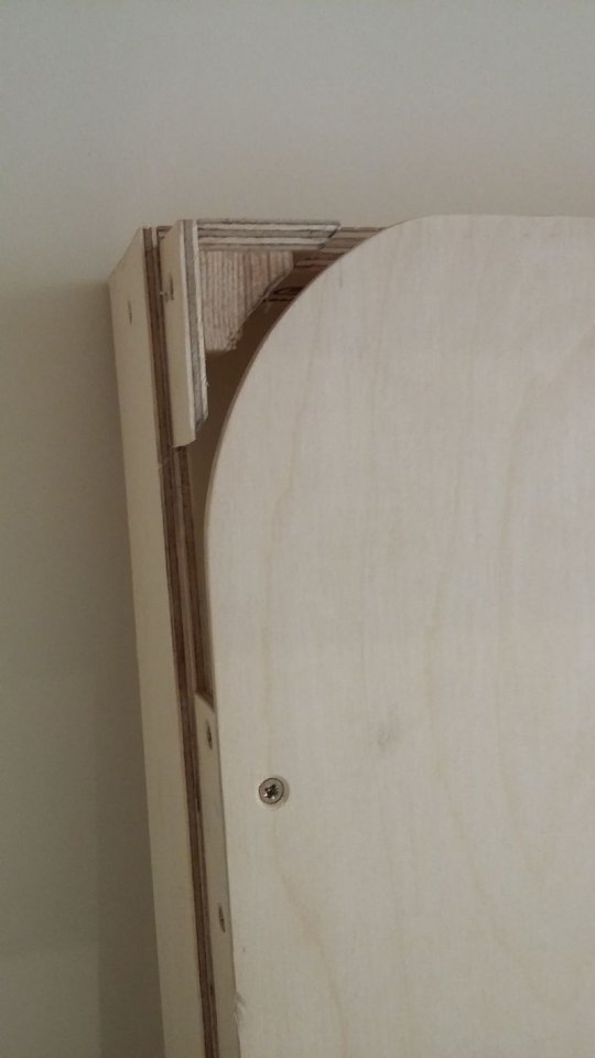

    Note the arrangement at the curved back corners of the baseboard, to allow the backscene (which I hope to have laminated) to fit behind the scenic area. The backscene will then be supported by birch ply sheeting on three sides (not fitted in these photos):

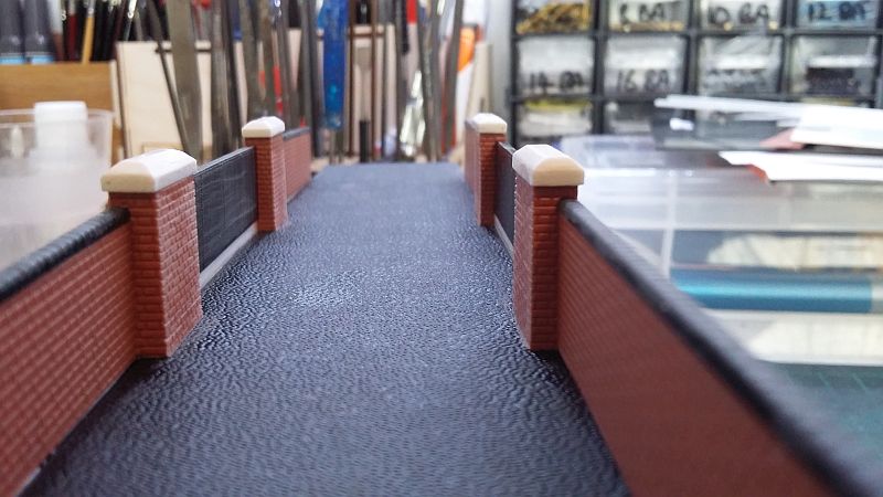

    I have also been doing more work on the overbridge.
    It still requires wing walls, parapet walls on the road approaches each side of the girder section and some Archers rivets adding to the girder itself:
    3 LINK, unklian, Bullhead and 4 others like this.

    The main boards are almost complete, apart from the proscenium arch. Note the 'groove' that runs round three sides for the removable backscene to fit into:
    The overbridge is almost complete, apart from gluing the wing walls on and adding Archers rivets the girders and, of course, painting and weathering:

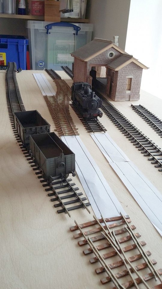

    I am now almost at the stage where track laying and general layout work can commence.
    This afternoon the almost-completed main baseboard was put up in the location where the work will be done and the positioning of the pointwork and track worked out, including the important location for the overbridge and the track into the fiddle yard:
    The next thing will be to cut the hole in the end panel for the track to get into the fiddle yard and then track laying can commence, starting with the tandem turnout and the track across the board joint.

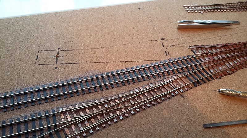

    I started track laying a few days ago and the bad weather in South Devon today resulted in a particularly productive day. Here is a selection of photos taken today:
    I made a start cutting the plastic webbing between the sleepers:
    BrushType4, Geoff, unklian and 8 others like this.
