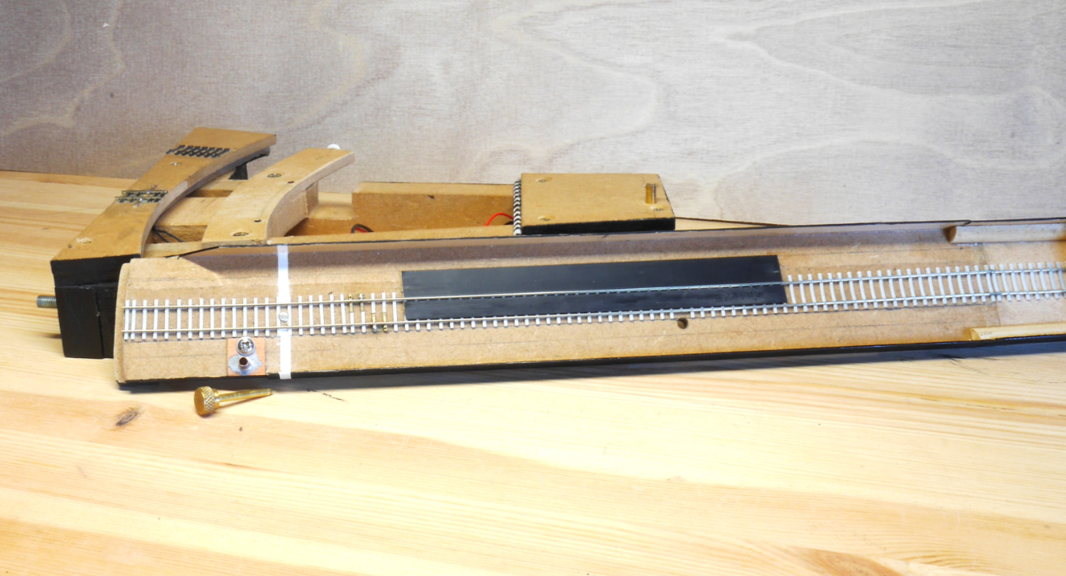

I use Electra Couplings designed in 1979 by John Whitehead and like most couplings, if made and mounted correctly they work extremely well. But, if you try and perform party tricks on curves that's asking for trouble; it doesn't take much of a curve either. What was happening was the couplings, made and mounted on my standard little bit of track, worked fine and mostly worked fine on the layout. However the combination of a curve, a badly placed electro magnet and exhibition operating meant that in order to see the coupling operate its delaying action I had to virtually stand in front of the layout obstructing the view of this enormous exhibit, something of which I was aware, resulting in me standing more to one side to afford a view to anyone minded to look. Because of the limited vision alluded to above the couplings were not doing what they're supposed to 100% of the time.

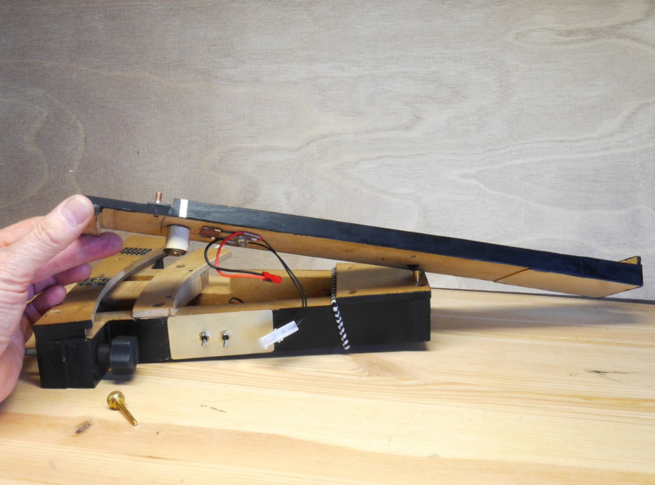

The result has been to install a second electro magnet but this time on the moving part of the sector plate. Even then, because the sector plate curves very slightly just prior to affording the stock access to the layout scenic section I took no chances and fixed it on a straight section. Result - satisfactory uncoupling and delay.
The bonus here is when people invariably ask about the couplings I can show exactly how they work. Don't know why I didn't think of this before. I always think it funny how we arrive at these solutions, but that's part of the pleasure of being a naff planner...! I said it because I knew you were thinking it.......
The first picture below shows the sector plate as it now appears. The operating switch for the elctro magnet is now alongside the section switch that cuts off power to fiddle at this end. In truth the other magnet is still in place and when I'm happy it'll never be used again I'll pull it out and assign the switch to some other function. The white painted band indicates the magnet location and black and white 'scrunchy' gets used when the sector plate framing is secreted beneath the baseboard for transit.
Here is the underside view showing the elctro magnet which is half of an old H&M point motor (SM3 I think - could be wrong), point motors of any hue aren't things I have ever really got into. The metal rod is drilled and tapped 10BA and is a force fit in the hole in the sector plate with coil being retained by a piece of brass sheet to which a 10BA bolt is soldered. If it ever fails (unlikely) it will be easy to remove, especially since as you can see the business part of the plate is detachable, the red connector is the feed to the track and the white one the feed to the magnet.
A better view of the sector plate track in which the magnet is easily seen where the white band is. Also, you will see to the right I extended the fiddle by about 2" (50mm) because as planned I intended to use the locomotives that ran up to the real Callerton when I had my cab ride viz Classes 31 and 37s and they with the little train fit - then Farish brought out the new tooled Class 40 I couldn't resist it but it meant an extension..! The black plastic sheet is a very handy 'railer' especially useful where the class 40 is concerned. I also had to cut out a piece of the sector plate framing on the far side so the electro magnet coil didn't foul it when the plate was aligned to the hidden rear siding.
