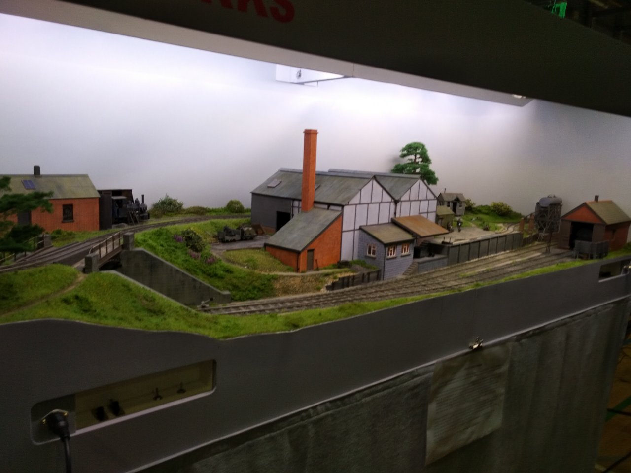

  12. Threadmark: Cameo competition
    Simpas Western Thunderer
    As promised,a couple of phone camera shots of the winning entrants. I'll trying put up the rest tomorrow.
    Below - the winner, 'Newton Heath Works' and below that 'Midland in Bristol' which took first and second place respectively. Not very good pictures admittedly but I was operating Callaton at the time I nipped out to take these rather rushed shots, but you'll get the flavour.
    Mick S
