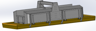

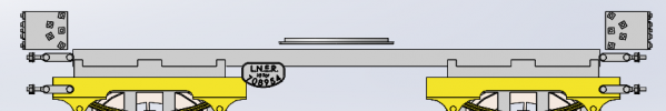

Aside from not 'mirroring' correctly, the nut has also flipped 90degrees on the stalk !!??
Could this be caused by some oddball 'Mates' associated with the original nut/bolt/washer ?
-Brian McK.
I think the whole component has translated rather than mirrored.
just checked the mirrors, they are all apparently correct in the tree, they are part of a list of mirrored components, all the others of which have behaved themselves.
One of life's mysteries!
S

In a brief moment of madness, I counted the rivets, I make it 556 between the two sides of the wagon, not including the cross beam, the T strapping or the doors, nor anything on the chassis. Happily the CAD does a good job of patterning & mirroring, and I have probably only modelled a tenth of a quarter of them. ( I only modelled half of one side, and mirrored the rest) Still, three reasonably relaxing evenings so far, and probably an hour or so more to go.
