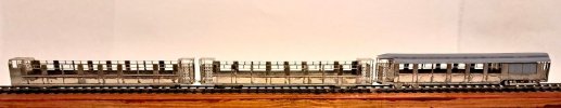

Going back underground again, Jim Watt is making a wonderful job of the Gate Stock.
The motor car easily shifts the other two cars, so that is a relief. The roofs and interiors will be 3DP. The grills on the motor car are 3DP as this was capable of greater resolution than etching.
