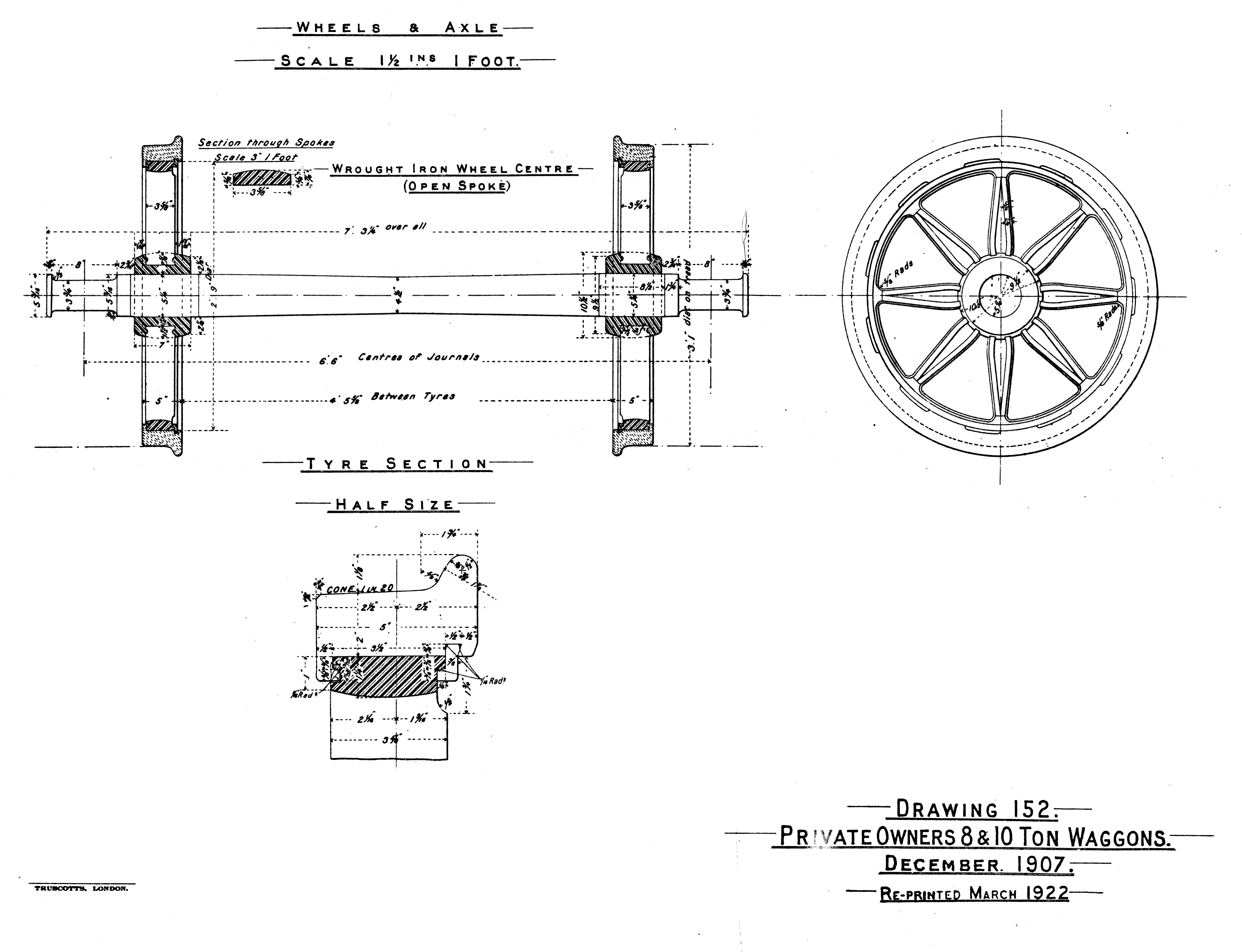

Jon - A few website now have scanned RCH drawings. The LMS Society is one and here's a typical axle, though later than your period. https://www.lmssociety.org.uk/assets/RCH_1907/RCH_1907_Dwg152.png

Subtract the minimum radius of the tapered portion of the axle from the maximum radius. Divide that by the linear distance between the positions of the two radii. The angle is the inverse tangent (often labelled ATAN on calculators) of that. Or just make trial cuts on a scrap piece of material until you get it right.
Nick
Ian_T
Jon, the taper is very slight.
Using an RCH axle as an example - the axle tapers down from 5.1/2" to 4.7/8th in the centre - a 5/8th difference. Thats over 50.25" total length "between tyres", so half that in effect.
A quick calculatation gives, if a=.326 and b=25.31 then angle A = 0.74° - it's a very slight taper.
In scale terms you are reducing 6.2mm down to 5.5mm (.7mm) over 28.45mm......you could see this if you looked closely - but would anyone ever do so in practice? Of course you'd know the taper was there! :)

At the time your wagon would have been built all axles were parallel. It was found they tended to break near the centre and the solution was found to be tapering the axle to allow some flexibility. The problem is mainly torsional forces due to wheels trying to go different speeds around curves.

I was referencing a Standard RCH 12t wagon axle - Dwg No 1020 - April 1923. :)
This is curious. A torsional load would (assuming a constant section) be evenly distributed along the axle, whereas the taper would appear to concentrate the stress at the narrowest section.
From a bending perspective, and ignoring cornering forces, the axle is in four-point bending and thus has a constant bending moment between the wheels. Again, the taper would appear to concentrate stresses at the smallest diameter. I suspect cornering forces are small compared to the weight.
I'm intrigued.
