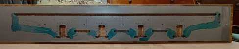

I started the project by creating a CAD model of the chassis parts. It’s not a complete model down to the last nut and bolt, and where there are identical or mirror image copies of the same component I don’t put them all in. It is easy to do in Fusion, but on the screen it just adds to the clutter. I only do enough to help me decide how it should be assembled, check on fits and clearances, and provide me with the data for some of the manufacturing methods.
As with the previous loco, I intend to try out some of the new manufacturing methods that are now available, but we will come to that later. Enough waffle, it’s time to start cutting metal.
