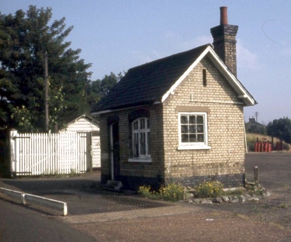

As an interlude I built the, dare I say, the Peco hut.
(Again, my tablet was used to take the photographs which unfortunately does not have sophisticated exposure settings)
The kit itself is plastic injection moulded and took all of 10 minutes to build the shell. However before building I wire-brushed the four walls 1. to provide a keying surface for the paint and 2. to provide some texture to the bricks.
All the paints used are Vallejo acrylics apart from the matt varnish which was Alclad.
The shell was painted with Wehrmacht red brown and the odd few bricks painted in various shades of a red/brown mix. Once dry I applied a mixed some Mig volcanic ash grey pigment with a drop of water and IPA and washed this over the building. After drying this was wiped off leaving the pigment in the mortar courses.
This process also removed some of the paint from the edges of the protruding bricks and a brown wash was applied to the shell which also darkened the mortar joints. I then applied some more pigment mix over odd parts of the building to imply mortar repairs.
The roof as supplied represents a felt roof. I wanted to try out the Vallejo sandy paste to see if I could make the roof appear as if it was roughly cast from concrete. The sandy paste was applied to the roof and allowed to set. Once set, I roughly sandpapered it to remove the high points then painted it with a mixture of buff, middlestone and stone grey followed by a brown wash. Once dry it was then dry-brushed with a mixture of buff and middlestone to accentuate the remaining high points.
The door was painted grey, followed by a brown wash then dry-brushed with a faded green and old wood colour. Ironwork was painted a black brown colour and the window frames were also painted faded green.
The whole ensemble received a coat of matt varnish. After which I then lightly dry-brushed using mixtures of reds, browns and buff. The final dry-brush application was downwards with a middlestone/buff mix to pickup the top edges of the protruding bricks and window ledge.
All that remains is the 'tidying up' weathering such as soot, algae streaks (for north face of building).
