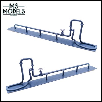

This has just arrived from MS Models of Chesterfield, bought through their eBay shop.
The model is not perfect, and the string courses below the tank are curving downwards ever so slightly; but the angled copings and the curved corner bricks are so typical of 19th century workmanship.
As one who was very sceptical of 3D printing (and got his fingers burned too many times) the technology is beginning to look useful. I mean, just imagine making this from scratch.
