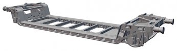

This (probably) isn't a wagon for my layout.
It's an SR Bulleid cast steel Lowmac, that I drew for my brother, though he didn't get to have an actual wagon. There's a preserved one on the Bluebell Railway, though this now has a steel plate floor.
Although goods traffic up the Tanat Valley was probably fairly limited in variety, there was, during several periods, pipe traffic for reservoirs constructed in the Welsh hills further west. Excavating machinery also arrived by train, though the only excavator photographed was on an LNER 20T bogie vehicle much longer than the Bulleid one. See below.
This is a half set of parts - it didn't have a floor, only movable cross bars, as built:

Intrigued by the Bulleid flatrol - I’d talked with Colin about the best way to tackle one of those, and it was sufficiently long ago that 3D printing was not really anywhere near up to the mark. Do you have any intention of marketing the files/ prints at all?
The Bluebell have one of the riveted ones with RIV fittings which looks a much easier proposition using ‘conventional’ techniques, and I’m tempted, but there are so many other things to model…
Barry37
These wagons were seen at Newhaven, which was Colin's favoured area for modelling. This is a pair on the quayside, c.1950. The right hand one seems to have borrowed some of the crossbars from the other wagon.
I've done some more work on the drawings - there's now a brake lever and brakeshoes, plus ribs for the load-bearing baulks.
I could supply a kit for this - DM me for details, or there's an email address & phone number on: deangoods.co.uk - we supply 16mm scale parts.
(I was going to put details here, but I'm not sure whether WT rules allow that, other than on the Small Ads pages)

For my layout, I'm allowing the once plentiful timber traffic to continue. Perhaps some of this would have been carried on pairs of single bolster wagons. This is the LNER-design BR wagon to D1/400.
Detail on the solebars and the bolts on the body corners are applied separately – printed with a 0.2mm nozzle, which would take ages to print a whole wagon. The surface finish isn't as good with a small nozzle on larger flat areas, either (these sides need a bit of sanding).
