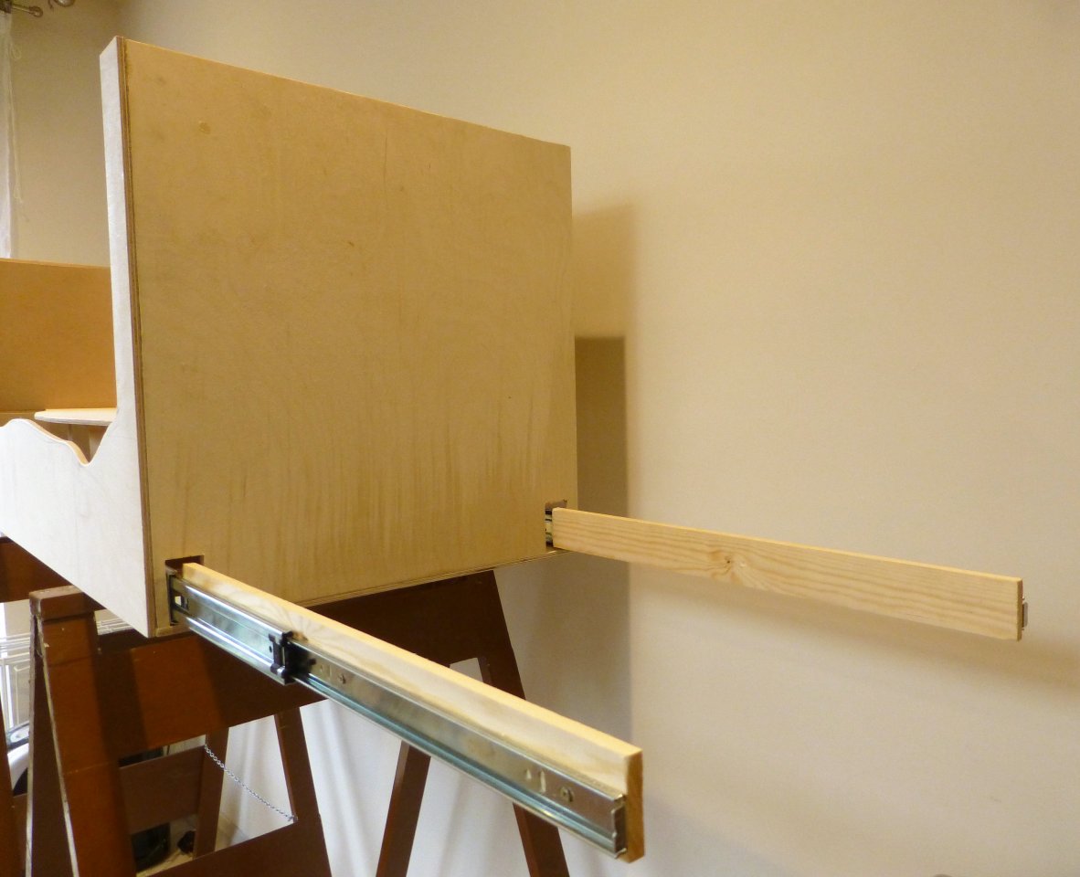

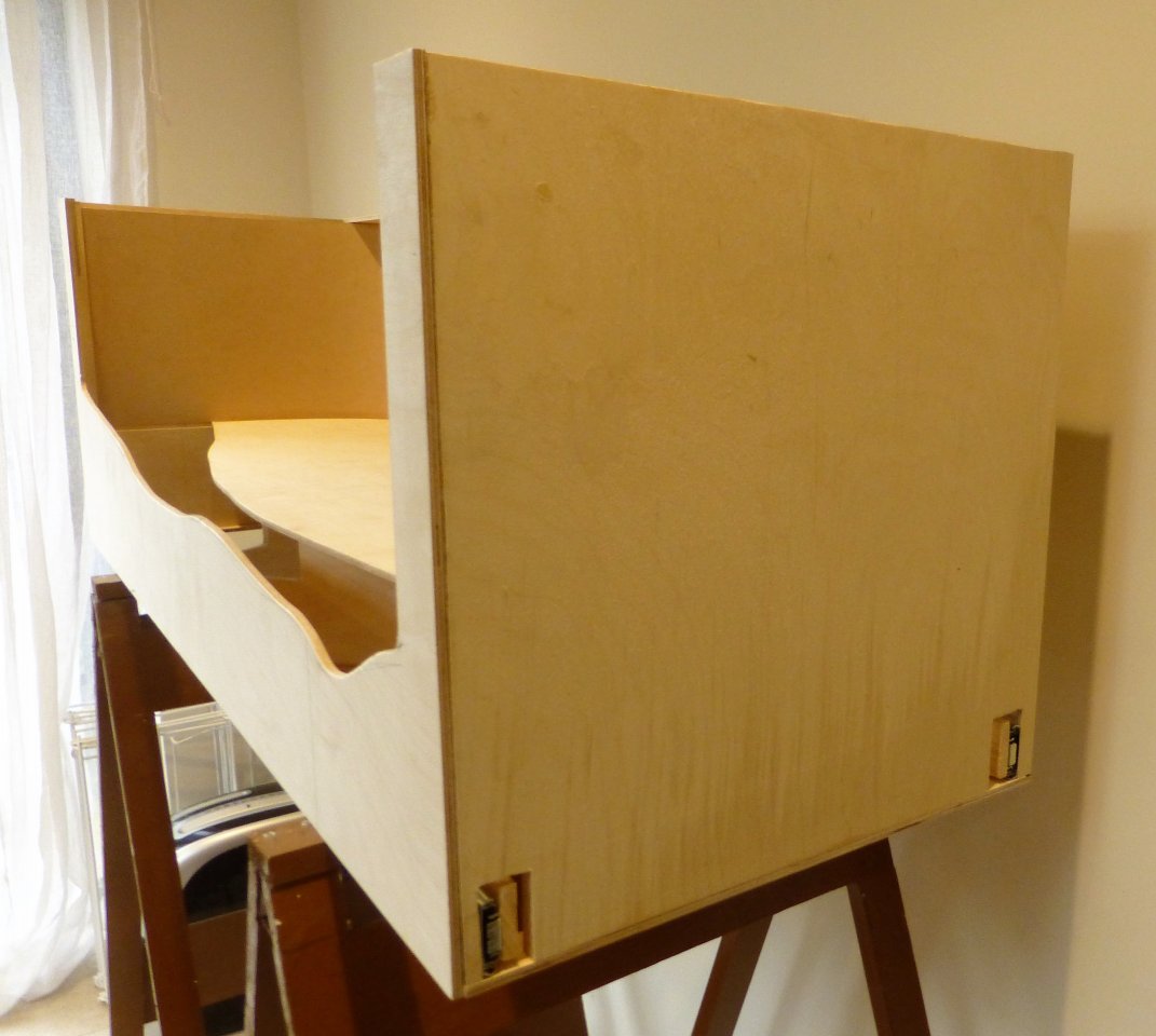

Well, I've spent a productive week in the North East staying with my very good friend Richard (he of Low Quay Yard in the competition), and we'v produced a baseboard each. They are the same design and dimension, just the track beds are different to reflect our separate plans.
We've fitted drawer runners in each end to facilitate the fiddle yards:
They are strong and secure. The idea is that the fiddle yards slot in and clamp to the baseboard, and it means that we only need two trestles. I must admit that I'm quite daunted by the prospect of designing these.

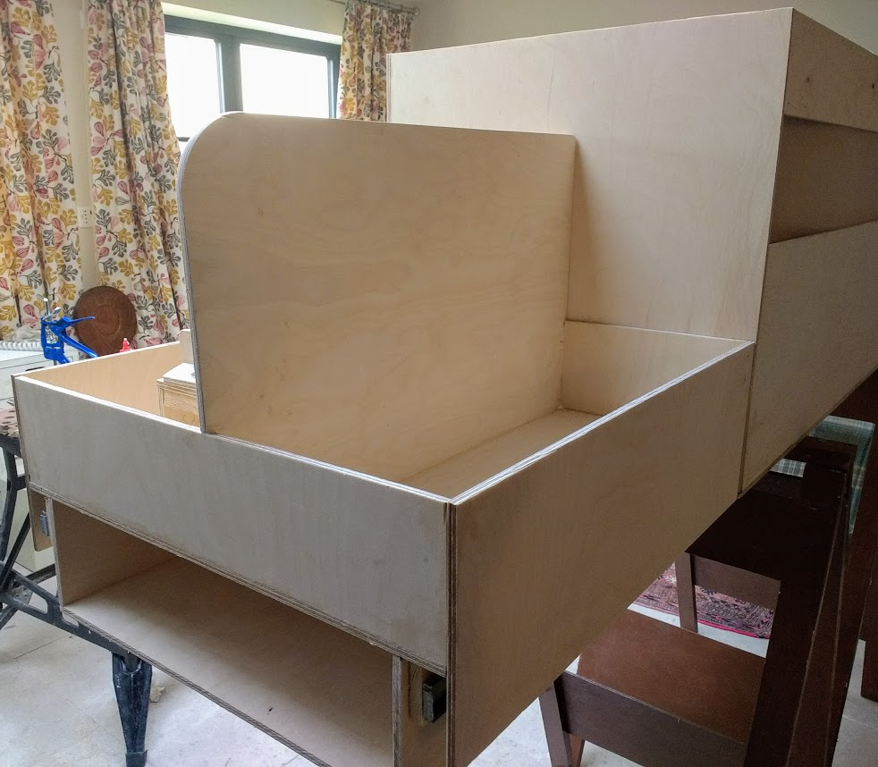

I have been working on the right hand fiddle yard. It's nearly finished, but I need a hinged front on the end for the stock box storage hatch. As you can see, the sliding sector plate is utterly simple, but it seems to work well; it only needs to accommodate two tracks which will both be permanently live.
Richard (Low Quay Yard) has also been working on his right hand fiddle yard, and it's looking great - come on Richard, get it posted!
The drawer runners seem to be working OK, but we have both added a single clamp underneath for added security.

Your fiddle yard and screen arrangement is really interesting. I like the idea of the sector plate being raised and visible from normal viewing position, and therefore part of 'the show', while you've also created loads of 'hidden' space for stock storage and other various uses - and the display screen looks great. Did Mr Occam influence your thinking on the automatic alignment of the tracks on the two-way sector plate using the stop-blocks? All very neat!

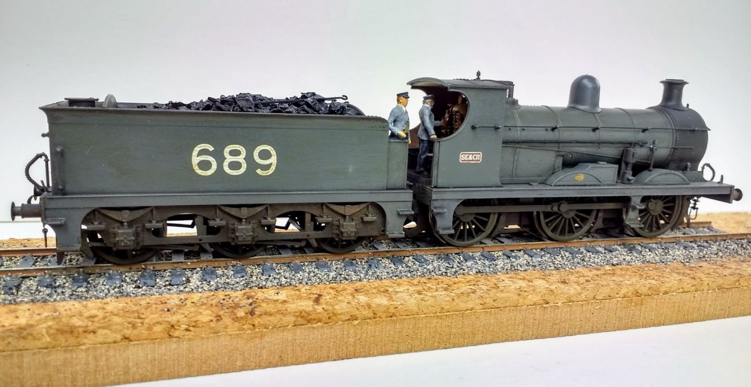

I've just finished weathering a loco. It's a Bachmann C Class in SECR 1917 wartime livery. Let's say it's around 1925/6 and she hasn't been repainted yet in Southern Railway livery. I wanted to make it look as if the paint job is worn but she still gets cleaned up occasionally.
I'm presuming that the crew will be wearing grey jackets, not blue ones - any ideas on that?

You could even push the boat out to 1929.... as some of the LBSC D tanks wore their Marsh umber livery until this date so not was all repainted immediately - the Southern perhaps even less so as they were concentrating on their electrification programme.
Anecdotal evidence suggests the SECR wartime zinc grey weathered to almost black if not cleaned.
From my understanding the blue denim locomotive crew clothing was introduced post nationalisation therefore white shirts, grey jackets and black trousers would be de rigueur.
John Rich
Gosh that's interesting, in my ignorance I always assumed blue denim was also worn pre war, how stupid am I for making that assumption. Think I am going to need to repaint some footplate crews !
Forever in Blue Jeans... I thought the same until I was researching the colours for the 1930's LMS Turbomotive crew clothing (driver, fireman and fitter). Which prompted me to look closely at railway uniforms in photographs.
Result: I too, have a few SR crew to repaint.....
John Rich
There is so much more to railway modelling and research than just the Engines and Rolling Stock, that's why I enjoy the hobby.
Yes, I've read that too somewhere. I had a go at reproducing that, but rather than looking darker it looked dirtier, so I cleaned it off. The final result is a compromise on that.
