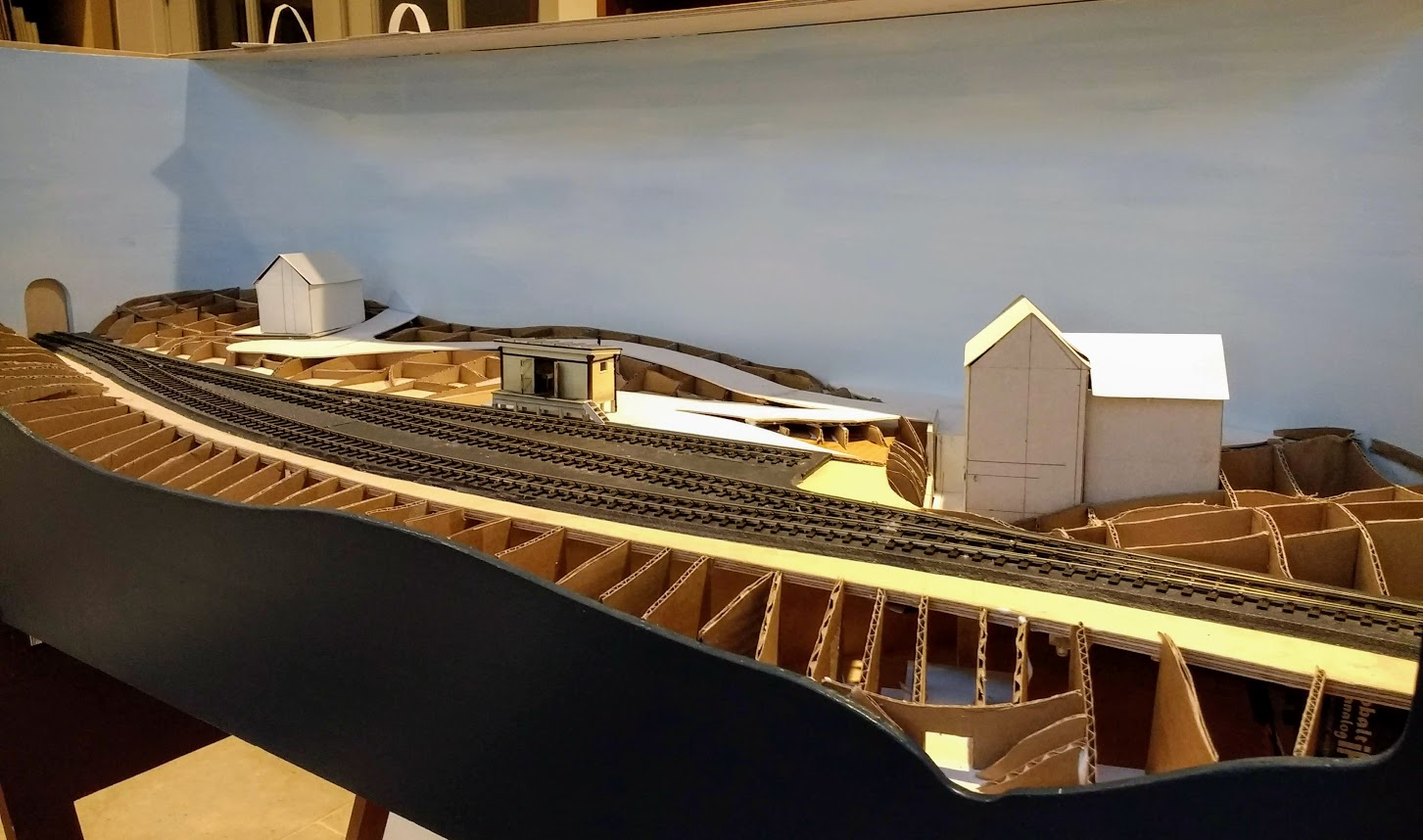

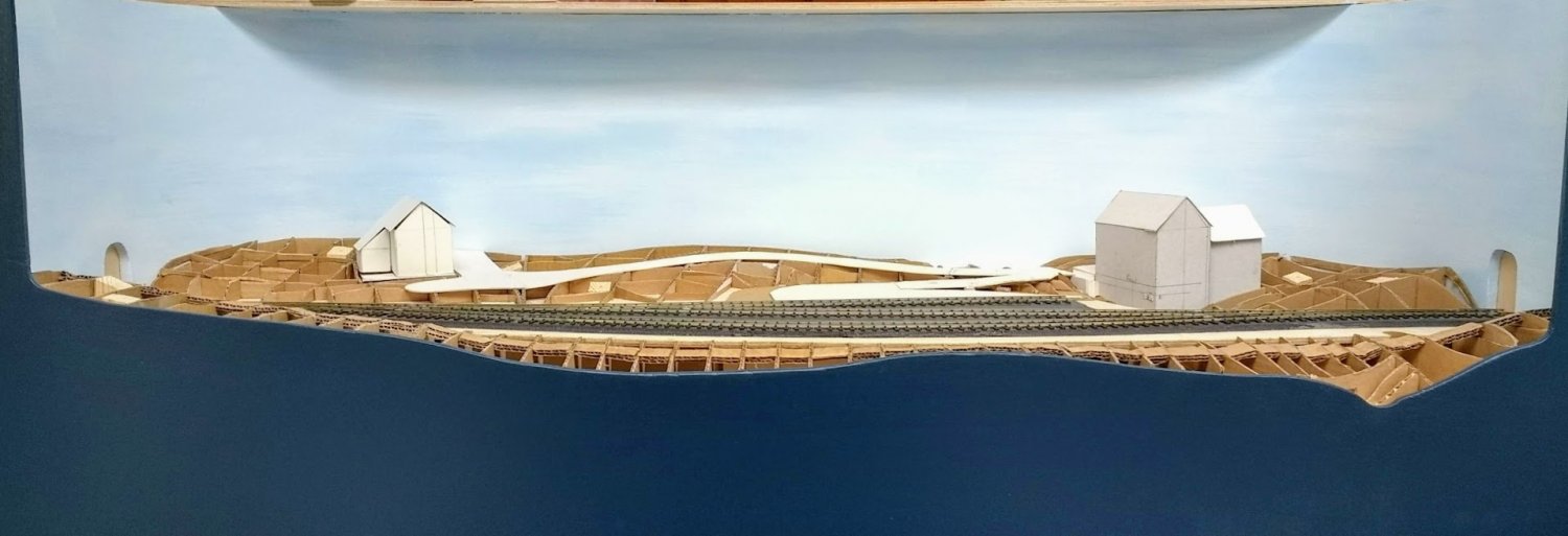

Creating scenery is a slow process! I'm doing it the old fashioned way with corrugated card and papier mache.
I've worked out where I want trees, hedges and fences. Trees have a little wooden block with a hole drilled in, and hedges and fences will have a double thickness of horizontal corrugated card to poke into. The buildings are mock-ups for now, and I've left a space the exact size of each with the intention of making the actual ones with cellars - Pendon-style. It should work as long as I'm careful with measurements.
For all my efforts, I figured that the miller's walk from home to work will be less than a minute - I hope he appreciates my landscaping. With the placement of trees, I've found myself becoming pretentiously artistic, thinking about the rule of thirds and the golden ratio. It's odd to think that while the real thing is just a random combination of nature and the needs of rural industry, we have the advantage of artistic artifice.

There's no quick way of doing this. It's just a case of putting my old hippie music on the sound system and going at it for a couple of hours at a time. As Winston would say, KBO!

It's got a very real feel of spaciousness, the less is more approach is helping. It is tempting to over populate model railways with all sorts of clutter sometimes, but the restraint shown here is excellent.
Thanks Tony - I really appreciate that comment. I keep reminding myself that what is left out can be as important as what is put in. In my original plans I probably had four times as many trees as I'm now working with.
As is so often said, time taken just standing back and looking is never wasted.

Hi Paul, this looks very good. The way you've condensed a landscape into a series of gentle undulations and a lane, so that they lead the eye around between the main structures, is really effective. I'm very interested in what you write about artifice - it seems to me that it's not just an advantage but a necessity because we simple don't have space to model a scale landscape, especially on a cameo. Artifice then becomes vital in creating a condensed (as in concentrated) portrayal of a landscape, without it becoming a caricature. Your landscape also defines a sort of "centre stage" area for the railway - very neat!

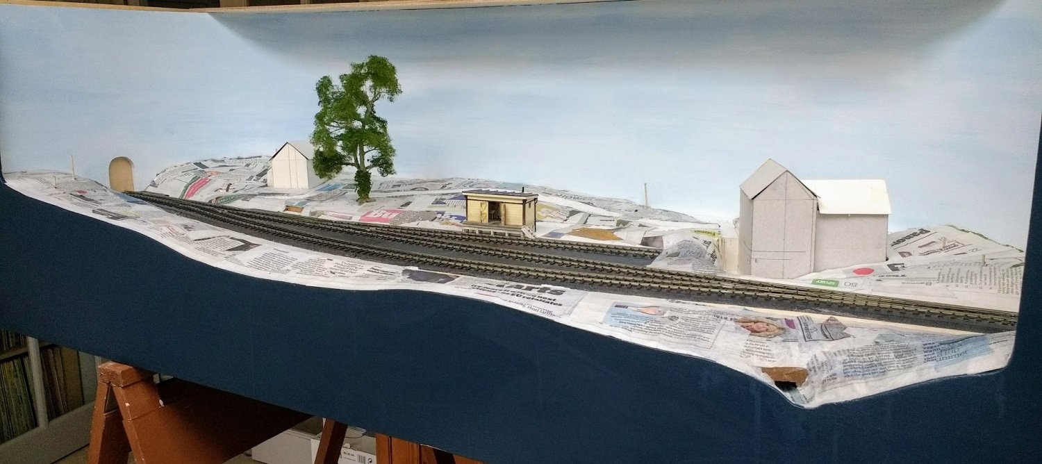

The last week has been fun and absorbing. It's like being back at primary school, and I say that as a retired primary school teacher.
The great thing is how adjustable it all is - an extra bit of scrunched up paper here - chop a bit out there, slap more on. I've completely forgotten about trains.
Once it has dried my plan is to seal it with a pale earth colour, sort out the lane and the paths, then paint a low backscene landscape. I'm quite daunted by that because I don't really consider myself to be an artist in that sense.
Then the layout will probably go away for a bit while I make the buildings.
