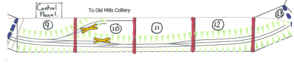

In the scenic area I found the magnets put in place by Rob had weakened so I added one in each position from underneath. Great! However having a play found a couple of point blades not working so I could not enter the shed or run around stuff.image.png.3a3e8f64ca496c1cfaabcb731c89ff72.pngThis meant I could not enter or exit from the routes marked X. The straight routes are OK. But shunting wagons from boards 12 and 13 to Old Mills colliery was convoluted!
I have repaired the loop point (2 attempts) but the shed one requires the return of my patience! It's detached in 2 positions.1756479631110.jpeg
