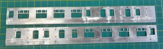

The sides were rubbed down with a fine decorators block to remove the shine and hopefully give the paint something to key to. In this image the top side has been treated but the lower is still to be done. Hopefully you can just make out the burr caused by the stamping process on the lower side:
